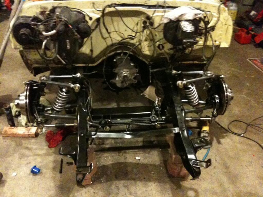

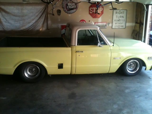

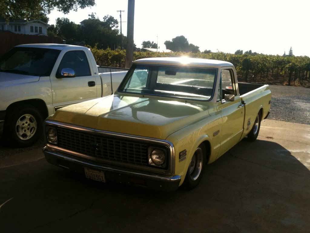

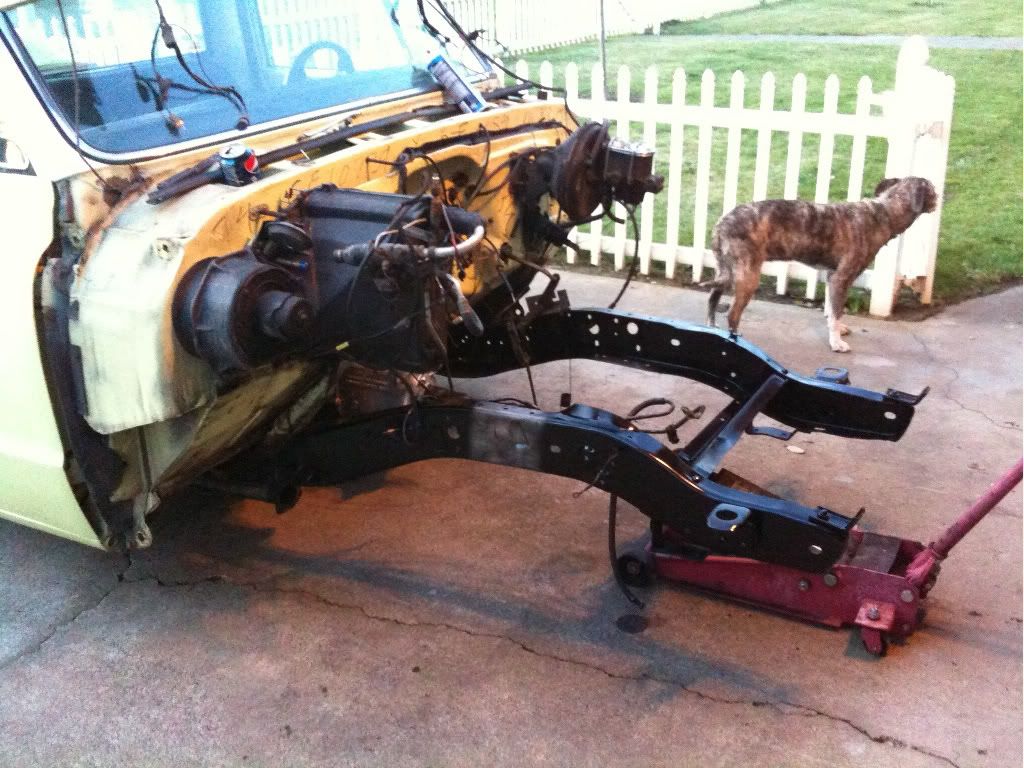

Here are some pics of my front suspension on my 72, the front wheels are moved in about 2 inches total and foward 3/4 of an inch, pics are at ride height (no bags) and i have plenty of clearance underneath, now its time to take the bed off and do a 4 link set up, but im trying to do a 55 210 at the same time so it may take a while. By the way the truck has a 383 with a muncie M21

Thanks merc. Its a Jim Meyer Weld in kit, and as far as the front wheels, if you look at 67-72 trucks that are "slammed" , the front wheel looks like its too far back, to me anyway, and the lower you go the further the wheel goes back.
