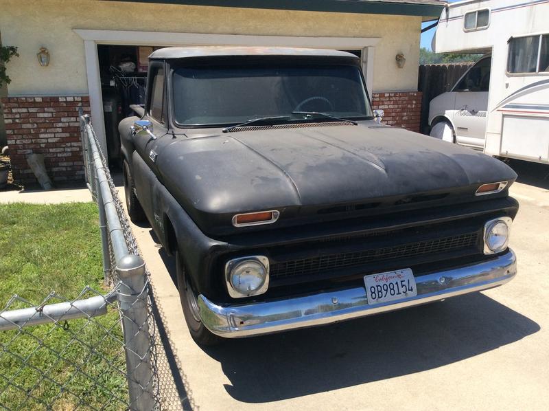

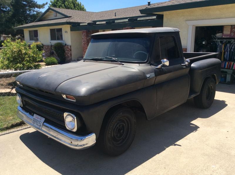

Just got this 65 c10 shortbed step side Sunday. Been working on the wiring the last 2 days. Tail, brake and blinkers weren’t working. Finally got all that fixed, pulled out to the curb for pictures for the insurance and now it won’t start....
I hope this isn’t a sign of things to come.....

Looks pretty straight, the cab fillers are still there right in front of the steps, good, usually they are gone, six or V8...? what trans...?

It’s got a 350 with a Edelbrock 4 barrel carb .... with a 3 speed.
