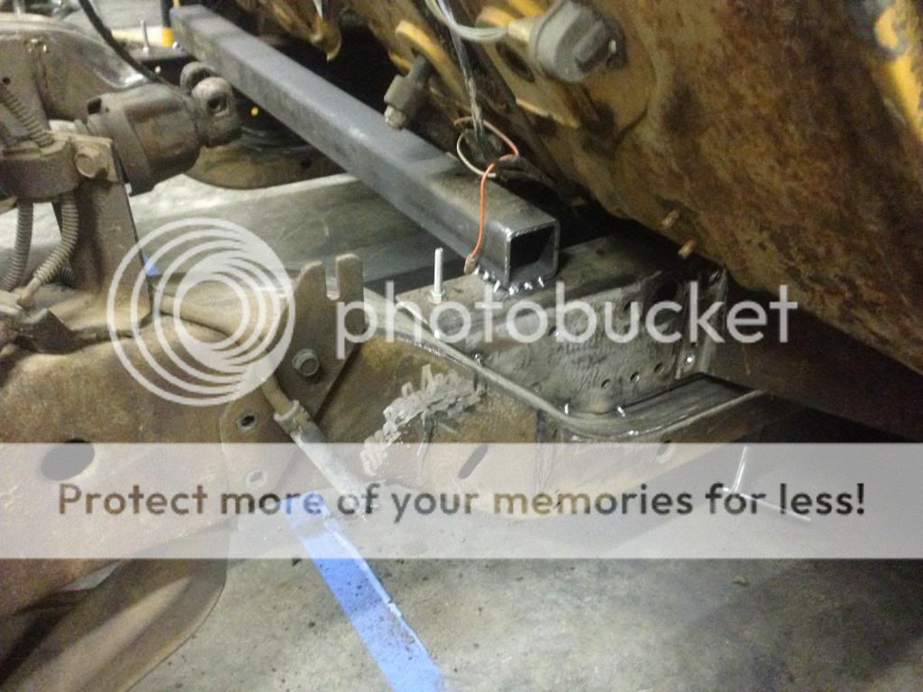

I got a mid-80s Suburban tank from a friend in Longview. It looks like it will be a good fit.
I've heard that this was a good swap so I gave it a try - kinda like the front clip - not trying to re-invent the wheel. :D It is a 40 gallon unit! The donor vehicle was gone so I didn't get any mounting stuff with it. I will have to check out the U-Pull-It this weekend...
I did have to move the last crossmember back as the tank is 35" long.
Looks good in there. Room above and below. Need to figure out the filler location. Do I put in a door on the side - round or square? Or do I just put in a recessed fill? Or a cap/fill that is flush? What are people out there running?
I also took out the gauges and the dash piece is cool! I can't decide if I want to restore the original gauges or get a kit. Probably the latter because it would be cheaper and I can make a couple aluminum pieces to fit. Speedway has a 6-piece kit for $210 that I am looking at.
Anyway, it's coming along nicely.
